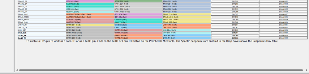

    • viktormyhome's avatar
      viktormyhome
      In Platform Designer my HPS GPIOs looks like:
      I am going to use them as outs, writting 0 or 1 to their DR register, DDR register contains 1 - configured as out
