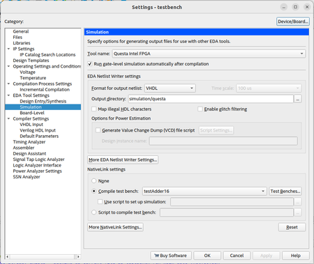

Check the error message and see what it complain about.
The "#Error error loading design" seems to indicate that the Questa is unable to find the design files.
Check if the path to the file being loaded is incorrect, or the path contains a space character, or the file does not exist.
Check the line 12 in the ...msim_gate_vhdl.do file and see what is it about.
Do you run a full compilation in the Quartus prior to launch the Questa to run gate level simulation?
