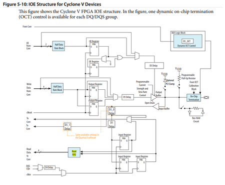

3 years agoHow to instantiate components of Cyclone V IOE for design.
Hello, I am trying to instantiate the DDR and read FIFO items that are integrated into the Cyclone V I/O elements (IOEs). I know you can instantiate DDR registers using the ALTDDIO IP. However, I h...

Structures like that are usually added as needed based on the design. If you add a FIFO IP and connect it to an I/O or use an IP that has a parameter for using the FIFO, the synthesized design would make use of that hardware. There's no specific IP as far as I know to implement that particular FIFO.

3 years agoHi Tucker,
There is step to infer fifo manually that might be help for you design to link at ddr output.
You may look at below documents.
