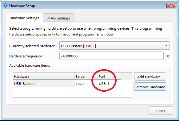

I am a newbie with Altera and Quartus, so my questions and terminology may not be phrased correctly. Nevertheless, here are my questions.
  1. How is the Hardware Port number assigned within Quartus?
  2. Can the Hardware Port number be controlled (manually assigned ) and how?
  3. Is the Hardware Port number and Cable name related?
I ask these questions because, I have a setup consisting of Windows 11, Quartus Prime Lite Edition Version 22.1std.1 and Altera USB Blaster II. My USB Blaster II has a default Port value USB-1. See my uploaded images.
This setup is confirmed operational. I can successfully flash an image to target. However, I am now trying to use this same setup to interface to legacy applications. It's unsuccessful. The legacy applications are hard coded with different Hardware USB values, e.g., USB-2, USB-3, USB-4, etc.
Note: Modifying the legacy applications is a no go.
I have searched within Windows for how to change the USB Blaster II Hardware Port value with no success. I have tried to use the Command Line at quartus_pgm -h but I am not sure what if any option is the correct option. So, if anyone in the Community can assist me, then thank you in advance!

    I believe the info is stored in the Windows Registry (on Windows, on Linux IDK).
    In my registry I see:
    And I have two USB Blaster devices on my system (a TerASIC blaster clone and a DE1 development board).
    As expected, the blasters are indexed by their USB 'Device ID' value (ie, VID/PID string values).
    I have no idea if you can play with the index values (0, 1) and rename those to (3, 4, etc).
