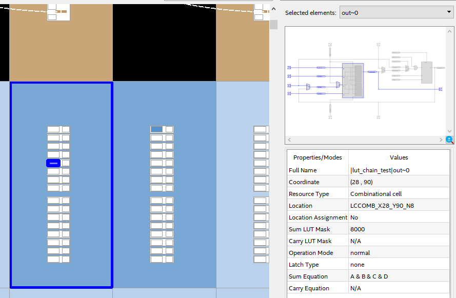

I implement very simple example of 6-input NAND. The place and route result of this design using 2 LE, which placed different LAB. I think it does not use LUT chain interconnect. I attached the project files.
Is there any example using LUT chain interconnect?

If you look into https://www.intel.com/content/dam/www/programmable/us/en/pdfs/literature/hb/cyclone-iv/cyiv-51002.pdf, the carry chain can only be used in Arithmetic mode. So it is not possible to implemented using NAND gate.
