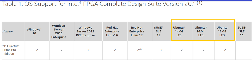

- KhaiChein_Y_Intel
The Intel Quartus Prime Pro edition software is not supported in Ubuntu 20.04.
https://www.intel.com/content/www/us/en/programmable/support/support-resources/download/os-support.html
