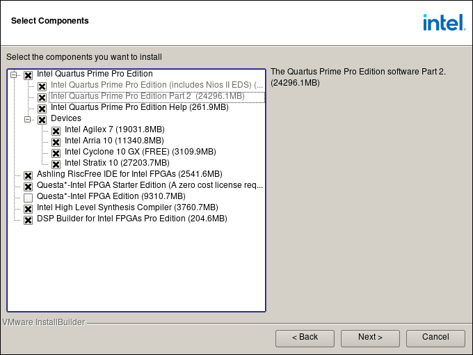

      I install all options, except the Questa FPGA edition. However, two of the selected are grey, whatever that means:
      Quartus install
      I get no errors during the installation.

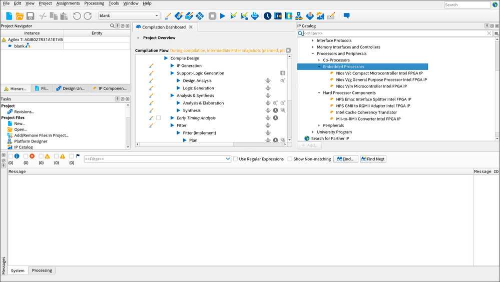

        This is a sample from yet another re-install and selecting a device which should have an embedded CPU, but no hard CPU is available in the IP selection:
        IP catalog after fresh re-install

    Thanks for the update. To further check, can you provide the screen shot of this “There is no "Hard Processor Systems" sub-menu under "Processors and Peripherals" when I select an AGIB027R29A1E2VR3 (e.g. a "B" device which should have a hard CPU core)”.
    • zutalors's avatar
      zutalors
      Although a different B device, but please see my post above of "02-27-2024 08:54 AM" (probably dependent upon timezone) which contains such a screenshot.
