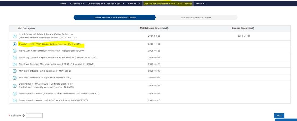

  • Get the Questa Intel FPGA Starter Edition simulator software.
    The Modelsim* - Intel® FPGA Edition (including Starter Edition) will be replaced by the Questa* - Intel® FPGA Edition (including Starter Edition) starting from the Intel® Quartus® Prime Pro Edition Software version 21.3 and Intel® Quartus® Prime Standard Edition Software version 21.1 onwards.
    The Questa basically works the same as the Modelsim.
    https://www.intel.com/content/www/us/en/software/programmable/quartus-prime/questa-edition.html
    Note that the Questa* - Intel® FPGA Starter Edition Software will now require a valid license (no-cost license) as compared to the Modelsim* - Intel® FPGA Starter Edition Software that does not need a license previously.
    Generate a license file from the Intel® FPGA Self-Service Licensing Center.
    FYI, you can get an evaluation license for non-starter edition.
