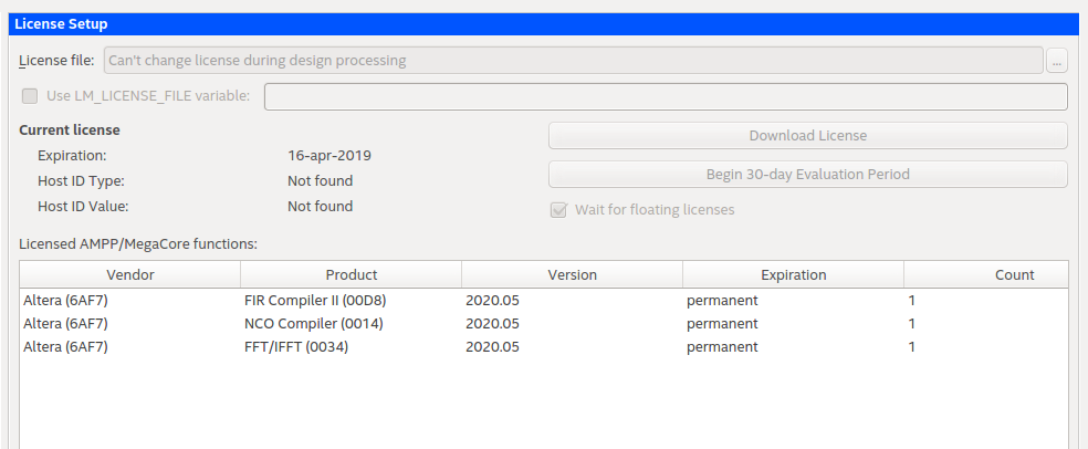

I have purchased a floating license from intel. I successfully added it to Quartus Prime and the NIC is matching. I followed the guide provided by intel and remove the SERVER lines in the .dat file. However I get the following error message when I try to compile my design:

Hi, I wrote a private message, but I can add the license file here as well: # Intel Corporation Software and/or Intellectual Property License File # Issued 19 June 2019 # Upgrade to these products will no longer be available after the Maintenance Expiration # date unless licenses are renewed. # Floating Server License # Primary Machine Name-Linux # Primary Machine ID-NIC ID 001c427e72e2 # Redundant Server 2-N/A # Redundant Server 3-N/A # Product License Summary: # Quartus II SE Floating, 1 Seat(s) # - Maintenance Expiration of 2020.05 ################################################################################ VENDOR alterad <path to daemon executable> VENDOR mgcld <path to daemon executable> ################################################################################ # FEATURE START # The following is a license file for the Mentor Graphics AXI3 Inline Monitor BFM # Number of seat licenses is 1 # License Expires 19-Jun-2020 INCREMENT mgcvipae mgcld 2020.06 19-jun-2020 1 7EBEAB33376DB5701572 \ \ VENDOR_STRING=6F7937F9 ISSUER=Intel SN=67777614 SIGN2="0833 6239 0905 \ 8D35 C90B 499A 2E08 1DEA EC8D FD7F 2ED1 0323 6008 96AA A6E3 1044 6D5D \ BDEB D54E 0AA1 770F AF42 5524 D86C 6697 084F 85DA 5D32 D86A 2CA3" # FEATURE END ################################################################################ # FEATURE START # The following is a license file for the Mentor Graphics AXI3 Master BFM # Number of seat licenses is 1 # License Expires 19-Jun-2020 INCREMENT mgcvipaeaxi mgcld 2020.06 19-jun-2020 1 1EFE3B939EC4F0AE1129 \ \ VENDOR_STRING=3282F7E1 ISSUER=Intel SN=67777615 SIGN2="1C19 B819 9FC4 \ DB8C E4CB C877 4DFA C395 3DE5 78E2 188B 208A 9B64 6C23 AE30 113C 0F71 \ 8ADA CE01 E3E2 D279 27F3 6776 9474 0029 DCC2 888E 82AB C82F 462B" # FEATURE END ################################################################################ # FEATURE START # The following is a license file for the Mentor Graphics AXI3 Slave BFM # Number of seat licenses is 1 # License Expires 19-Jun-2020 INCREMENT mgcvipaeaxi mgcld 2020.06 19-jun-2020 1 1EFE3B939EC4F0B01127 \ \ VENDOR_STRING=3282F7E1 ISSUER=Intel SN=67777617 SIGN2="0283 17BF 43AB \ 40B7 F868 5C5F BF2B DF98 722E B9D3 7147 54ED 9FC3 B582 2FA4 1EAD D3E9 \ 00BD 1AA9 30E9 D201 A311 E338 D62F F5D3 F39C A558 B44D 025B 7821" # FEATURE END ################################################################################ # FEATURE START # The following is a license file for the Mentor Graphics AXI4 # Number of seat licenses is 1 # License Expires 19-Jun-2020 INCREMENT mgcvipaeaxi4 mgcld 2020.06 19-jun-2020 1 AE2E8B434344678D40A5 \ \ VENDOR_STRING=3A1ADF7F ISSUER=Intel SN=67777620 SIGN2="0943 8776 175E \ 1882 BFAA 2832 48DB DEDC 1792 F403 0141 FA91 F1BE DA17 B549 0025 01B9 \ 76EE E4BE ED43 4F25 6BCE FDD9 E324 4FCF F64C 0897 4116 61C9 1E16" # FEATURE END ################################################################################ # FEATURE START # The following is a license file for the IP Base Suite Package part number for IP # Base Suite (NCO, FFT, FIR Compiler II) # Number of seat licenses is 1 # No license expiration date PACKAGE ip_base alterad COMPONENTS="6AF7_00D8 6AF7_0014 6AF7_0034" \ OPTIONS=SUITE SIGN="153B EB57 5B09 B585 D1D5 3EA8 1CC3 CB52 \ DC01 2214 9CDA 4A26 598F 76C2 C126 00FE 5122 A135 BCB7 9D0A \ 2BAD 5F03 BE38 FE97 EDF8 5B2A 55F2 99E3 1468 72B8" INCREMENT ip_base alterad 2020.05 permanent 1 296C52A462F4 \ VENDOR_STRING="iiiiiiiihdLkhIIIIIIIIUPDuiaaaaaaaa11X38DDDDDDDDpjz5cddddddddtmGzGJJJJJJJJbqIh0uuuuuuuugYYWiVVVVVVVVbp0FVHHHHHHHHBUEakffffffffD2FFRkkkkkkkkWL$84" \ DUP_GROUP=UHD SIGN="1F50 E943 E7AC B82A F05A E846 7859 75E2 \ 4869 E355 3FD1 0D35 A195 EE40 CFDC 04DC 5380 DC6B 600A F6B6 \ 95C9 9DEE 9BF1 7F96 69E9 0FCF 7B17 DC01 9A23 076F" # FEATURE END ################################################################################ # FEATURE START # The following is a license file for MAX+PLUS II Software # Number of seat licenses is 1 # No license expiration date FEATURE maxplus2 alterad 2020.05 permanent 1 F0CD3592A5C7 SIGN="0F75 \ EB2D 9C06 6164 548A 0177 6E5C 93B4 BBF1 C0E6 B5D2 5F17 A0E7 \ 89AC 08D2 0F64 66C7 F26D 959A EBD0 B665 7A64 694E 1FF9 BF04 \ AFE5 5022 4E19 99FC AAAA" # FEATURE END ################################################################################ # FEATURE START # The following is a license file for MAX+PLUS II Verilog # Number of seat licenses is 1 # No license expiration date FEATURE maxplus2verilog alterad 2020.05 permanent 1 EC8185BAC0A6 \ SIGN="0B31 DD91 CBBD 9E6B AEE6 0BD5 6D57 C478 7414 E96B 75F8 \ 0C72 B7A0 6429 6A48 1739 2F56 F34A B158 4DFF F298 72E7 2434 \ 98BF 4269 A642 95C4 328C 63BD 0455" # FEATURE END ################################################################################ # FEATURE START # The following is a license file for MAX+PLUS II VHDL # Number of seat licenses is 1 # No license expiration date FEATURE maxplus2vhdl alterad 2020.05 permanent 1 F3F744D28F9B \ SIGN="1A6B 65DC 0B73 8CE1 4468 EB4D E010 A843 F1CC E85C 714C \ C8F4 9F36 9435 5269 0FD8 C8D5 DBF4 74A4 8E93 51C2 9A60 8EBC \ 3266 F3C4 E72F CC6B 4C20 316C 1CC5" # FEATURE END ################################################################################ # FEATURE START # The following is a license file for the Intel Design Security feature for the Quartus # II Software. # Number of seat licenses is 1 # No license expiration date FEATURE quartus_nonvolatile_encryption alterad 2020.05 permanent 1 \ 7B25AC53A880 SIGN="0F4A 07B9 75D1 3276 F840 7DA4 93A9 1539 \ FA08 718E D2BA CA8D 2FC8 9AB4 B281 02E0 CEAA 6365 1E69 8D34 \ 2858 DCBD 0BD4 96B3 B3CB 8BEE 55AD A3BD 60DC 9CF5" # FEATURE END ################################################################################ # FEATURE START # The following is a license file for the Quartus II Subscription Edition Floating # Number of seat licenses is 1 # No license expiration date FEATURE quartus alterad 2020.05 permanent 1 87CB8B638287 SIGN="1C93 \ 49A1 3FD7 9CF0 2381 BDC0 CEB3 934B BDD9 CFF1 CEA3 2A34 CD29 \ B22E 12D4 1667 9962 A2E7 BABD 0FA6 680E 9B79 8A53 8E3A 1FAB \ 4D98 6CA4 0E97 7179 4100" # FEATURE END ################################################################################ # End of Intel Corporation Software and/or Intellectual Property License File. Issued 06/19/2019 Thanks.

Suspected this error occurs because the FlexLM library has been upgraded to v11.16.1.0. Could you help check on this? Kindly upgrade the license daemon software on your license server/client PC to the newer version. The new daemon software can be downloaded from the website. https://www.intel.com/content/www/us/en/programmable/support/support-resources/download/licensing/daemons.html
