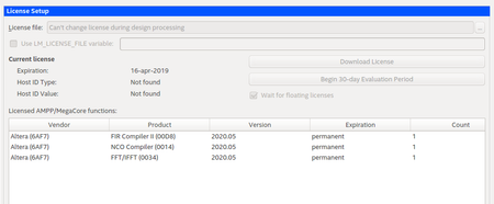

I have purchased a floating license from intel. I successfully added it to Quartus Prime and the NIC is matching. I followed the guide provided by intel and remove the SERVER lines in the .dat file. ...

Hi, I wrote a private message, but I can add the license file here as well: # Intel Corporation Software and/or Intellectual Property License File # Issued 19 June 2019 # Upgrade to these products will no longer be available after the Maintenance Expiration # date unless licenses are renewed. # Floating Server License # Primary Machine Name-Linux # Primary Machine ID-NIC ID 001c427e72e2 # Redundant Server 2-N/A # Redundant Server 3-N/A # Product License Summary: # Quartus II SE Floating, 1 Seat(s) # - Maintenance Expiration of 2020.05 ################################################################################ VENDOR alterad <path to daemon executable> VENDOR mgcld <path to daemon executable> ################################################################################ # FEATURE START # The following is a license file for the Mentor Graphics AXI3 Inline Monitor BFM # Number of seat licenses is 1 # License Expires 19-Jun-2020 INCREMENT mgcvipae mgcld 2020.06 19-jun-2020 1 7EBEAB33376DB5701572 \ \ VENDOR_STRING=6F7937F9 ISSUER=Intel SN=67777614 SIGN2="0833 6239 0905 \ 8D35 C90B 499A 2E08 1DEA EC8D FD7F 2ED1 0323 6008 96AA A6E3 1044 6D5D \ BDEB D54E 0AA1 770F AF42 5524 D86C 6697 084F 85DA 5D32 D86A 2CA3" # FEATURE END ################################################################################ # FEATURE START # The following is a license file for the Mentor Graphics AXI3 Master BFM # Number of seat licenses is 1 # License Expires 19-Jun-2020 INCREMENT mgcvipaeaxi mgcld 2020.06 19-jun-2020 1 1EFE3B939EC4F0AE1129 \ \ VENDOR_STRING=3282F7E1 ISSUER=Intel SN=67777615 SIGN2="1C19 B819 9FC4 \ DB8C E4CB C877 4DFA C395 3DE5 78E2 188B 208A 9B64 6C23 AE30 113C 0F71 \ 8ADA CE01 E3E2 D279 27F3 6776 9474 0029 DCC2 888E 82AB C82F 462B" # FEATURE END ################################################################################ # FEATURE START # The following is a license file for the Mentor Graphics AXI3 Slave BFM # Number of seat licenses is 1 # License Expires 19-Jun-2020 INCREMENT mgcvipaeaxi mgcld 2020.06 19-jun-2020 1 1EFE3B939EC4F0B01127 \ \ VENDOR_STRING=3282F7E1 ISSUER=Intel SN=67777617 SIGN2="0283 17BF 43AB \ 40B7 F868 5C5F BF2B DF98 722E B9D3 7147 54ED 9FC3 B582 2FA4 1EAD D3E9 \ 00BD 1AA9 30E9 D201 A311 E338 D62F F5D3 F39C A558 B44D 025B 7821" # FEATURE END ################################################################################ # FEATURE START # The following is a license file for the Mentor Graphics AXI4 # Number of seat licenses is 1 # License Expires 19-Jun-2020 INCREMENT mgcvipaeaxi4 mgcld 2020.06 19-jun-2020 1 AE2E8B434344678D40A5 \ \ VENDOR_STRING=3A1ADF7F ISSUER=Intel SN=67777620 SIGN2="0943 8776 175E \ 1882 BFAA 2832 48DB DEDC 1792 F403 0141 FA91 F1BE DA17 B549 0025 01B9 \ 76EE E4BE ED43 4F25 6BCE FDD9 E324 4FCF F64C 0897 4116 61C9 1E16" # FEATURE END ################################################################################ # FEATURE START # The following is a license file for the IP Base Suite Package part number for IP # Base Suite (NCO, FFT, FIR Compiler II) # Number of seat licenses is 1 # No license expiration date PACKAGE ip_base alterad COMPONENTS="6AF7_00D8 6AF7_0014 6AF7_0034" \ OPTIONS=SUITE SIGN="153B EB57 5B09 B585 D1D5 3EA8 1CC3 CB52 \ DC01 2214 9CDA 4A26 598F 76C2 C126 00FE 5122 A135 BCB7 9D0A \ 2BAD 5F03 BE38 FE97 EDF8 5B2A 55F2 99E3 1468 72B8" INCREMENT ip_base alterad 2020.05 permanent 1 296C52A462F4 \ VENDOR_STRING="iiiiiiiihdLkhIIIIIIIIUPDuiaaaaaaaa11X38DDDDDDDDpjz5cddddddddtmGzGJJJJJJJJbqIh0uuuuuuuugYYWiVVVVVVVVbp0FVHHHHHHHHBUEakffffffffD2FFRkkkkkkkkWL$84" \ DUP_GROUP=UHD SIGN="1F50 E943 E7AC B82A F05A E846 7859 75E2 \ 4869 E355 3FD1 0D35 A195 EE40 CFDC 04DC 5380 DC6B 600A F6B6 \ 95C9 9DEE 9BF1 7F96 69E9 0FCF 7B17 DC01 9A23 076F" # FEATURE END ################################################################################ # FEATURE START # The following is a license file for MAX+PLUS II Software # Number of seat licenses is 1 # No license expiration date FEATURE maxplus2 alterad 2020.05 permanent 1 F0CD3592A5C7 SIGN="0F75 \ EB2D 9C06 6164 548A 0177 6E5C 93B4 BBF1 C0E6 B5D2 5F17 A0E7 \ 89AC 08D2 0F64 66C7 F26D 959A EBD0 B665 7A64 694E 1FF9 BF04 \ AFE5 5022 4E19 99FC AAAA" # FEATURE END ################################################################################ # FEATURE START # The following is a license file for MAX+PLUS II Verilog # Number of seat licenses is 1 # No license expiration date FEATURE maxplus2verilog alterad 2020.05 permanent 1 EC8185BAC0A6 \ SIGN="0B31 DD91 CBBD 9E6B AEE6 0BD5 6D57 C478 7414 E96B 75F8 \ 0C72 B7A0 6429 6A48 1739 2F56 F34A B158 4DFF F298 72E7 2434 \ 98BF 4269 A642 95C4 328C 63BD 0455" # FEATURE END ################################################################################ # FEATURE START # The following is a license file for MAX+PLUS II VHDL # Number of seat licenses is 1 # No license expiration date FEATURE maxplus2vhdl alterad 2020.05 permanent 1 F3F744D28F9B \ SIGN="1A6B 65DC 0B73 8CE1 4468 EB4D E010 A843 F1CC E85C 714C \ C8F4 9F36 9435 5269 0FD8 C8D5 DBF4 74A4 8E93 51C2 9A60 8EBC \ 3266 F3C4 E72F CC6B 4C20 316C 1CC5" # FEATURE END ################################################################################ # FEATURE START # The following is a license file for the Intel Design Security feature for the Quartus # II Software. # Number of seat licenses is 1 # No license expiration date FEATURE quartus_nonvolatile_encryption alterad 2020.05 permanent 1 \ 7B25AC53A880 SIGN="0F4A 07B9 75D1 3276 F840 7DA4 93A9 1539 \ FA08 718E D2BA CA8D 2FC8 9AB4 B281 02E0 CEAA 6365 1E69 8D34 \ 2858 DCBD 0BD4 96B3 B3CB 8BEE 55AD A3BD 60DC 9CF5" # FEATURE END ################################################################################ # FEATURE START # The following is a license file for the Quartus II Subscription Edition Floating # Number of seat licenses is 1 # No license expiration date FEATURE quartus alterad 2020.05 permanent 1 87CB8B638287 SIGN="1C93 \ 49A1 3FD7 9CF0 2381 BDC0 CEB3 934B BDD9 CFF1 CEA3 2A34 CD29 \ B22E 12D4 1667 9962 A2E7 BABD 0FA6 680E 9B79 8A53 8E3A 1FAB \ 4D98 6CA4 0E97 7179 4100" # FEATURE END ################################################################################ # End of Intel Corporation Software and/or Intellectual Property License File. Issued 06/19/2019 Thanks.
