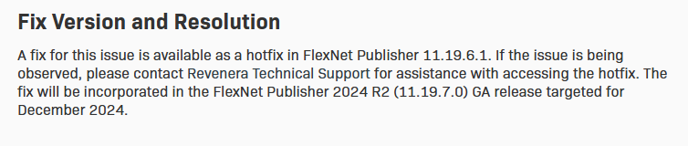

I have now also tried flexlm 11.19.6.0 with alterad to 11.19.6.0 and experience the same issue. It looks like a fix is available in FlexNet Publisher 11.19.6.1. When will this version of the daemon be available? We are currently prevented from upgrading our daemon to make use of newer versions of Quartus Pro.

The issue is with the alterad executable, which I believe is provided by Altera but built on FlexNet software. FlexNet have a fix for the issue as described above but Altera must incorporate it into a newer version of the daemon. The Altera licensing daemon needs to use at least FlexNet version 11.19.6.1.

Flexnet Publisher 11.19.7.0 has now been released. When will you be able to release an updated version of the altera licensing daemon based on 11.19.7.0
