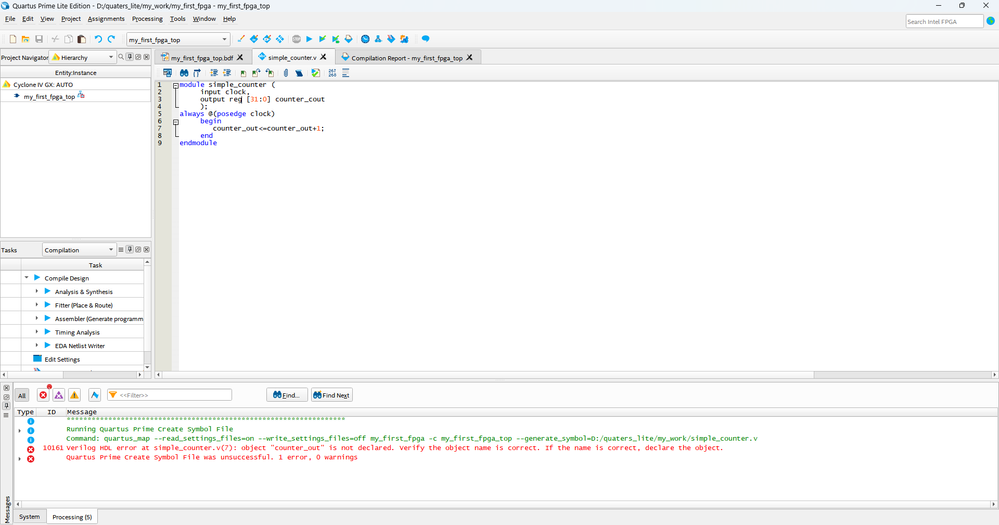

Eventhough my verilog code is correct it is showing me a syntax error

    Your declaration calls it counter_cout but you're using it as counter_out. The names don't match.

    counter_out is not declared, counter_count is declared. Please use the correct and same keyword for declarations.
