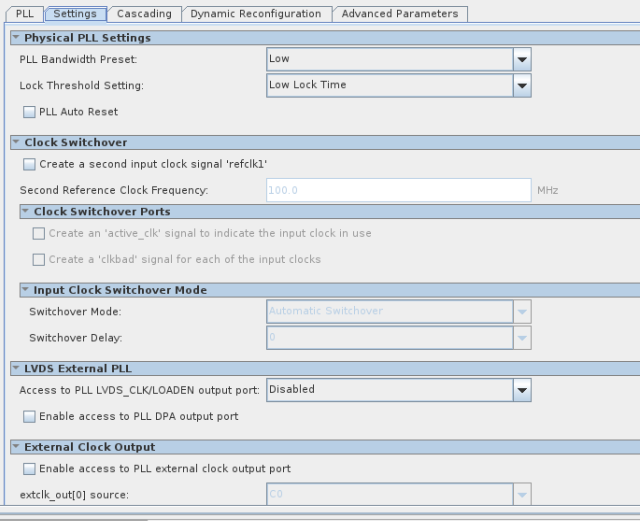

      Here are my settings from Platform Designer. I have also tried the N,M and C values listed under Advanced parameters with no change.
