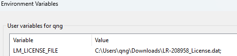

How to solve this? Can you tell me the steps?
Unable to check a license. Make sure your license file environment variable (SALT_LICENSE_SERVER, MGLS_LICENSE_FILE, LM_LICENSE_FILE)
is set correctly and then run 'lmutil lmdiag' to diagnose the problem.
Unable to check a license. Vsim is closing.
** Error: Invalid license environment. Application closing.
Error.

Make sure you have downloaded the Questa license from SSLC site (screenshot):
Make sure also you have set the LM_LICENSE_FILE environment variable (screenshot):
