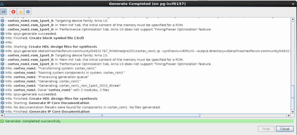

  • KhaiChein_Y_Intel's avatar
    KhaiChein_Y_Intel
    I tried to generate the HDL using the .ip file provided, the HDL is successfuly generated. I cannot replicate the same error as yours. Could you provide the full design.QAR for investigation?

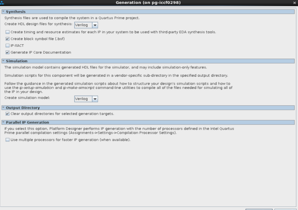

    KhaiChein_Y_Intel
    Yes. You may remove the video.
    Initially, I thought the error that you had reported is on the Third Party simulation model.
    After watching the video, I tick the first check box and the error occured. I will update once I received the feedback from the team Thanks for showing the steps to reproduce the error.
    KhaiY
    KhaiChein_Y_Intel
    The team is working on this error. Kindly untick the Clear output directories for selected generation targets to generate the HDL as a temporarty workaround.
