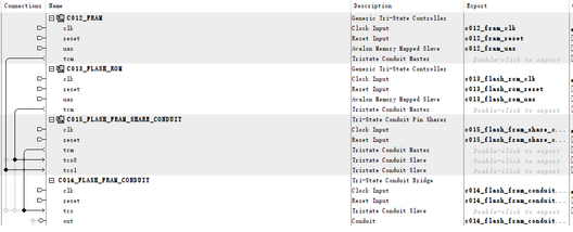

When Tri-State Controller IP During Generate Testbench System, the following error occured . How should I fix it?
Info: send_message Error TB_Gen: C012_FRAM.tcm is not exported for sim partner
Error: TB_Gen: C012_FRAM.tcm is not exported for sim partner
Error: Error: TB_Gen: C012_FRAM.tcm is not exported for sim partner
Info: Done
Error: There were errors creating the testbench system.
Info: Finished: Create testbench Platform Designer system
- ShengN_altera
Probably have to export C012_FRAM tcm port and connect externally with wire in rtl. Seems like there's something externally call sim partner.
