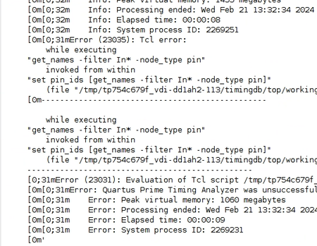

Error running TCL script after upgrading from Pro 22.4 to Pro 23.3
- 2 years ago
Hi there, please use the following tcl:
load_package flow
load_package report
#load_package sta
project_new toplevel_Characterization -overwrite
set_global_assignment -name TOP_LEVEL_ENTITY toplevel_Characterization
set_global_assignment -name DEVICE 1SD110PJ1F43E1VG
foreach sfile [list BlockSubsystem.vhd toplevel_Characterization.vhd] {
set_global_assignment -name VHDL_FILE $sfile
set_global_assignment -name USE_TIMEQUEST_TIMING_ANALYZER ON
execute_module -tool map
set pin_ids [get_names -filter In* -node_type pin]
foreach_in_collection pin_id $pin_ids {
set pin_name [get_name_info -info full_path $pin_id]
set_instance_assignment -to $pin_name -name VIRTUAL_PIN ON
set pin_ids [get_names -filter Out* -node_type pin]
export_assignments
execute_module -tool fit -args --plan
project_close
BTW, instead of using quartus_sta, please use quartus_sh -t Synthesis.tcl .
