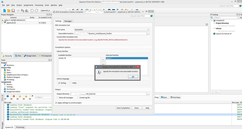

- SohanHPatel
Thanks for your respose @ShengN_Intel .
I have already tried for re-installing the same. As your attached video, tried same but getting this error although have selected the path where vsim is located. - ShengN_altera
Check this forum case link https://community.intel.com/t5/Intel-Quartus-Prime-Software/Questa-exe-not-being-seen/m-p/1539328#M80514. I had reported this bug to internal team already.
Please following the exact steps below for workaround (as mentioned in video):
1.After re-installing the software tool.
2.Specifying the Executable location path as ../questa_fse/win64 and Output directory path then ignoring the warning message, click Start Compilation.
3.If see this message Specify the simulation tool executable location. pop up, click OK to close the pop up, then Click at the Executable location tab and then press Enter. After that Start Compilation.
4.If still can't, install both questa_fse and questa_fe then follow the steps before again.

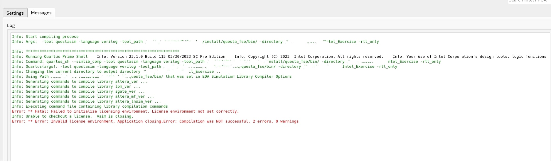

Ohh great! Now working but facing another issue related to License file.
If I invoke vsim from bin directory then it's working as I already set LM_LICENSE_FILE variable but during running from Quartus tool, it's showing error related to License file.
Have attached the screenshot for the same.
Thank you for your time @ShengN_Intel.
Sohan - ShengN_altera
Hi Sohan,
Check this link https://www.intel.com/content/www/us/en/docs/programmable/683472/22-1/and-software-license.html and this link https://www.intel.com/content/www/us/en/programmable/quartushelp/17.0/mapIdTopics/jka1465598270294.htm
Specifying the following commands below in .cshrc or .bashrc file (Linux):
export LM_LICENSE_FILE=<path to license>:$LM_LICENSE_FILE
setenv LM_LICENSE_FILE "<path_to_license_file>"
Note: Linux: You must source your .cshrc (source ~/.cshrc) or .bashrc (source ~/.bashrc) file before restarting the software.
Sheng
- SohanHPatel
Yes these things have solved the license error. but then only simulator library is getting compiling for long time. Simulator is not getting open. How can I open Simulator in quartus prime pro edition.
