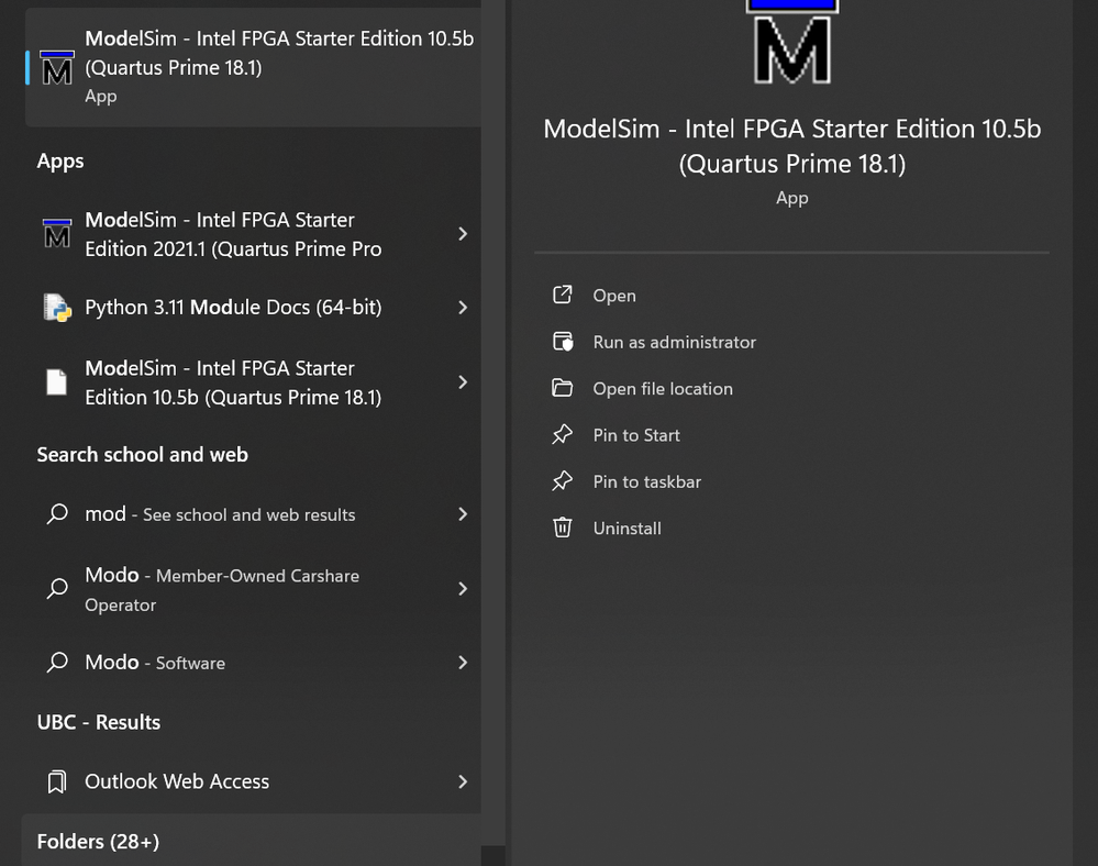

I have an Asus ROG Zephyrus Core i 9 running on Windows 11 and am required to use Quartus Prime 18.1 version. When I try to open ModelSim, I get the error: "The application was unable to start correctly (0x000007b)."
Is there anything I can do to fix this issue?

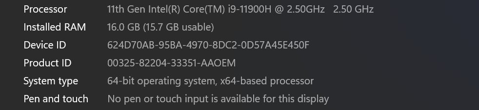

I have reinstalled it a couple of times. I even tried the 20.1 version and tried to look for missing extensions or documents that might be the cause. (I thought this might be one: https://learn.microsoft.com/en-us/cpp/windows/latest-supported-vc-redist?view=msvc-170) My computer is well capable enough to run it too, so I am clueless of what could be the issue. (Here is my system info)
