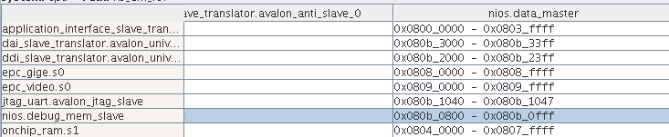

I am having an issue with elaborating generated files from a Platform Designer project. I inherited a CPU project and needed to add interfaces to it so I could connect it to other Avalon bus designs in my project. I intended to add three Avalon MM Slave Translators which are in the picture below as application_interface, dai, and ddi.

I've tried moving one of the slaves up to 0x7800_0000-0x7803_ffff but that didn't seem to work. I also grouped all of the new slave interfaces into one and gave that a larger address width which also didn't work.
