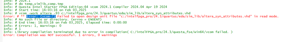

Hello together,
I downloaded the latest version from Quartus 24.3.
If I want to make the simulation of a testbench, I get the following error:
Can somebody help my, what does the error mean and how I can fix it?
Thanks in advanced.

The (vcom-7) error message indicates that a problem occurred while trying to open the specified file.
The problem is most likely due to the actual file being missing from the directory where the warning occurred, an incorrect or inaccessible file path, or perhaps insufficient permissions.
Please verify that the file exists, the directory path is correct, and that you have the necessary permissions to access the directory.

I can not find the file altera_syn_attributes.vhd at this folder. What could be the reason for that?
