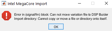

I'm creating a block in DSP Builder using the MegaCore Import in the library. After instantiating the block with all the necessary parameters in Qsys, I've generated HDL file and then return to DSP Builder so that my block is generated in this software. However, I've received an error notification as follows:
This is my first time seeing this error. Could anybody help me with this ?

As I understand it, you encounter some problem with the megacore import. By merely looking at the error message, it seems to say that the target directory that you are importing is no accessible. One of the possibility is due to the write permission to that directory. Would you mind to share with me you files, detailed steps to import and DSP builder version that you are using? I would like to try performing problem replication on my side if I have the right DSP Builder version. Thank you.

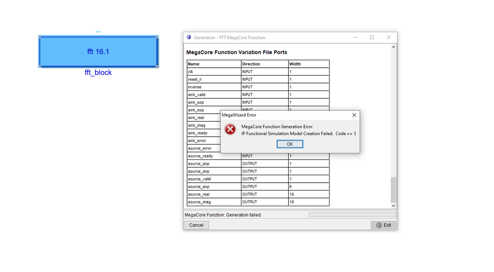

I'm using Quartus version 16.1 and Matlab R2018a. As you can see, I'm having trouble with the megacore functions in DSP Builder. For example, I'm using the FFT Megacore Functions to generate the IP, but there are still the errors:
I've already run the command "alt_dspbuilder_setup_megacore" as suggested in the DSP Builder Handbook for installing the megacore functions. Did you have any problems with using the megacore functions like that ever before ? Let me know if you have any ideas to fix this error. Thank you.
