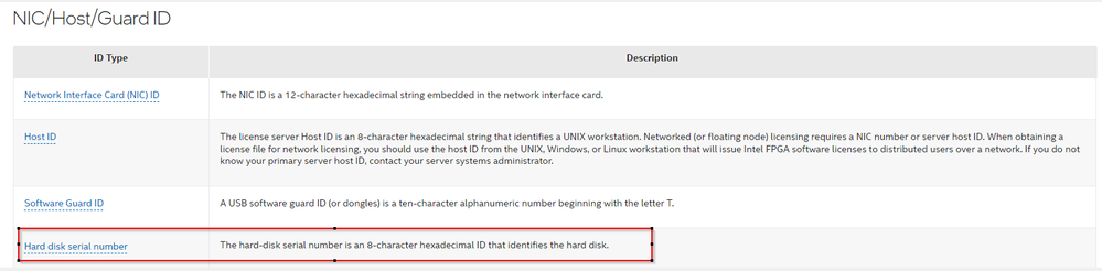

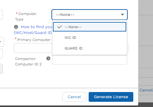

I want to activate my DSP Builder License using the Hardware disk serial number, but in the activation process, there is no “Hardware disk serial number” option, so I am confused.
CAN I activate my license on Hardware disk, or I must activate the license using the NIC ID method?
5 Replies
- ShengN_altera
Yes, only NIC ID or Guard ID.
