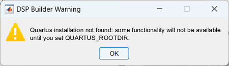

2 years agoDSP Builder is not starting
Hi there, I'm trying to use Windows 11 to open the DSP Builder in MATLAB 2023a. I am getting this error, though. Since I have to start working as soon as possible, any assistance would be ver...

2 years agoHi,
Before running DSP Builder, set QUARTUS_ROOTDIR to refer to an Intel Quartus Prime Standard installation. Then the various Intel Quartus Prime related features in DSP Builder use that Intel Quartus Prime Standard installation.
For more info, please refer 2.4. DSP Builder for Intel® FPGAs Device Support Section in user guide.
