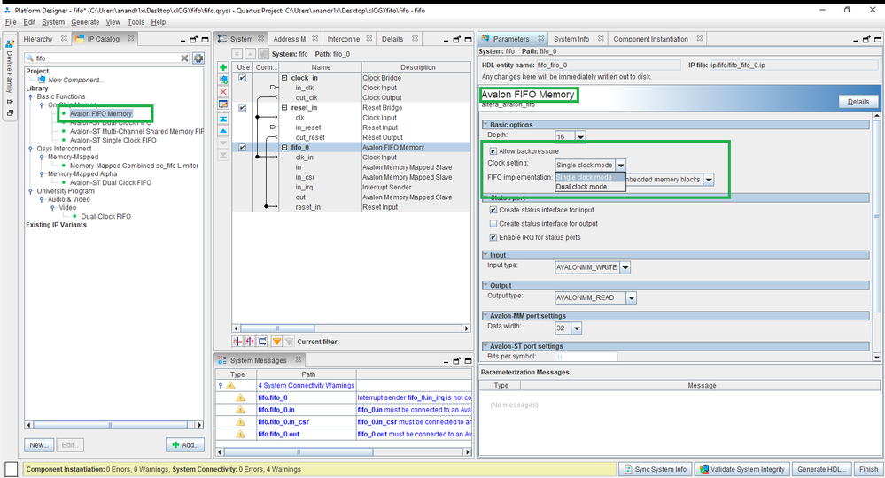

  • I checked with the Quartus Prime 18 version, and since the Cyclone10GX device is free, it does support the FIFO IP. I can see this IP present in the IP Catalogue. Check your license file setup for the tool and make sure its valid.
    Check the screenshot I've uploaded. Its the Pro v18 tool and Cyclone10GX device and you can see the FIFO IP on the right pane. I can even customize it and select the SCFIFO or DCFIFO type.
    If nothing else works, I suggest you upgrade the tools to the latest 18 version and check.

    1. You can use "Avalon FIFO Memory" from QSYS IP Catalog and from parameters Tab ->Basic settings -> clock setting->you can selects either SCFIFO and DCFIFO.
    2. Yes, You can perform auto update.
