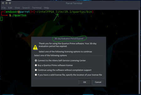

6 years agoDoes anyone know how to run Quartus 19.1 Lite (non-licensed) on Linux (Parrot)?
I have installed version 19.1 of Quartus on Linux (Parrot). But although it is the Lite version, the program appears as a Standard Edition 30-day trial, and it does not allow me to use the functions ...

The About Quartus Prime indicates that the software you are using is the Standard edition. Could you reinstall the Lite edition software software?
https://fpgasoftware.intel.com/19.1/?edition=lite&platform=linux

6 years agoYes, actually that is weird. I installed the Lite version. I also installed some previous versions and the same thing happens.
