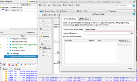

1 year agoDE1-SOC 5CSEMA5F31 isn't detected in Quartus Program Device
Hello, I'm having trouble programming my DE1-SoC from the Quartus Programmer. The board is powered and connected correctly and I've managed to find and program it before, multiple times, but even th...
Fred_Barkins
1 year agoI Try with
$ cat /etc/udev/rules.d/51-usbblaster.rules
SUBSYSTEM=="usb", ATTR{idVendor}=="09fb", ATTR{idProduct}=="6010", MODE="0666"
SUBSYSTEM=="usb", ATTR{idVendor}=="09fb", ATTR{idProduct}=="6810", MODE="0666"
Still nothing.
