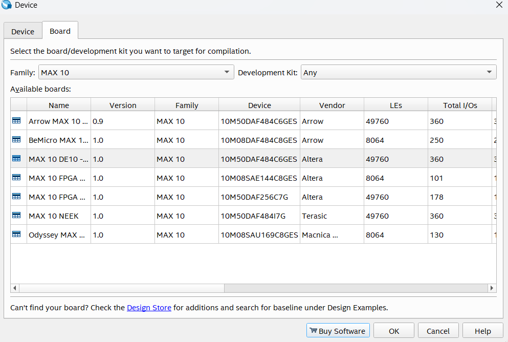

    I have 1 further question however, I have decided to go with the DE10-Lite as it is a bit more advanced. But when i try add the DE10-Lite board in Quartus Prime Lite 23.1, it only has the 10M50DAF484C6GES FPGA. While the DE10-Lite board i use has a 10M50DAF484C7G FPGA. Does this pose any problems?

    I have the 10M50DAF484C7G selected as my device but when I try to add a board as seen in the image below. Then the only possible DE10-Lite board is equipped with the 10M50DAF484C6GES FPGA. I also can't add another board as the link in the image when not being able to find the board doesn't work.
    Do you recommend me not choosing a board and only selecting the 10M50DAF484C7G as a device without selecting a board?

    I would avoid opening a new project using the board template. Those device part name is likely outdated years ago.
    Just create a new project with your FPGA device selected.
