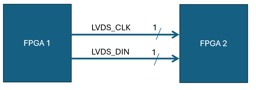

I am trying to send some data serially over a very simple SERDES interface made of a single LVDS clock and data going from FPGA 1 to FPGA 2.
In the receiver FPGA (FPGA 2), I want to use SERDES without DPA.
My LVDS_CLK is running at 50MHz. The SERDES factor is 8. Therefore my LVDS_DIN rate is 400MHz (50MHz *

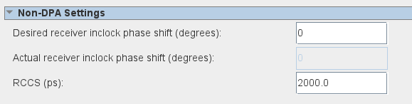

In the IP wizard for the LVDS SERDES, there is this RCCS setting in the Receiver Settings tab.
Is the correct way to configure the input delay using this RCCS value (and not the SET_INPUT_DELAY constraint)? If so, how does this account for the min and max delay settings? Don't I need two separate settings for the SETUP and HOLD timings to be verified?

    In non-DPA mode, use RSKM, TCCS, and sampling window (SW) specifications for high-speed source-synchronous differential signals in the receiver data path. If there is additional board channel-to-channel skew, consider the total receiver channel-to-channel skew (RCCS) instead of TCCS where .
    Now you just need to set the RCCS, then it'll be auto implemented into auto-generated .sdc.
    RCCS = (Clock trace delay) - (Data trace delay) + margin
    Skew(ps) = (Trace length different in mm) * (propagation delay per mm, typically 5ps/mm for FR4)
    For example if your pcb analysis shows that the clock trace is 2mm longer than the data trace:
    Skew = 2mm * 5ps/mm = 10ps
    Add margin = (e.g. 20ps) = 30ps
    Set RCCS to 30ps
