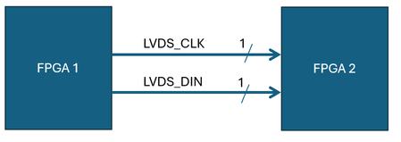

Cyclone 10 SERDES Receiver Timing Constraints

Use the Intel® Quartus® Prime software from version 14.0.a10 onwards to generate the required timing constraint to perform proper timing analysis of the LVDS SERDES IP core in Intel® Arria® 10 and Intel® Cyclone® 10 GX devices.
In non-DPA mode, use RSKM, TCCS, and sampling window (SW) specifications for high-speed source-synchronous differential signals in the receiver data path. If there is additional board channel-to-channel skew, consider the total receiver channel-to-channel skew (RCCS) instead of TCCS where .
Now you just need to set the RCCS, then it'll be auto implemented into auto-generated .sdc.
RCCS = (Clock trace delay) - (Data trace delay) + margin
Skew(ps) = (Trace length different in mm) * (propagation delay per mm, typically 5ps/mm for FR4)
For example if your pcb analysis shows that the clock trace is 2mm longer than the data trace:
Skew = 2mm * 5ps/mm = 10ps
Add margin = (e.g. 20ps) = 30ps
Set RCCS to 30ps

- Lakshman-Athukorala1 year ago
Thank you very much Sheng, that makes sense to me!
