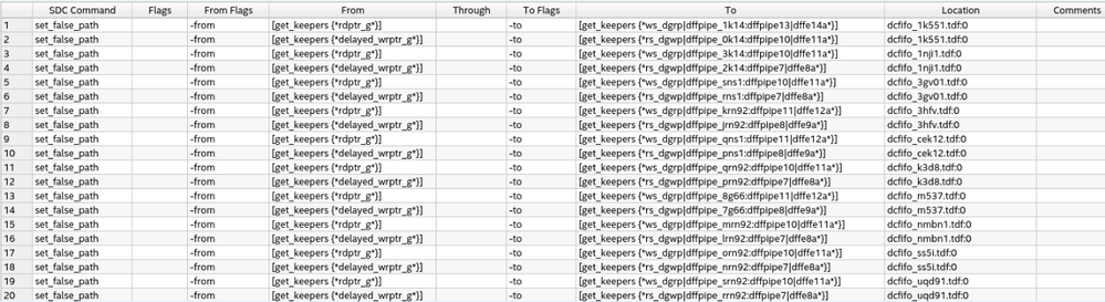

CDC-50007 design rules violation are coming internal from DCFIFO. What is the Altera suggestion for the violation internal to the IP.
I can see DC_FIFO has false path constraint embedded in the IP. I am wondering why these violations are coming even when false path constraint there on those paths.

Hi M,
Have you enabled the "Generate SDC File and disable embedded timing constraint" option in the IP?
https://www.intel.com/content/www/us/en/docs/programmable/683522/24-2/dcfifo-timing-constraint-setting.html
Does compiling the standalone DCFIFO IP have the same issue?
If so, could you share the design file?
