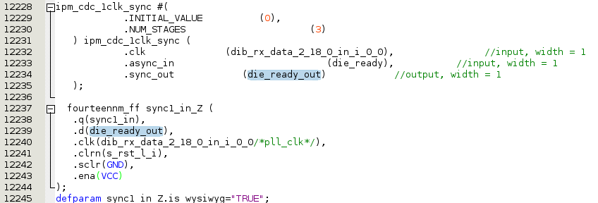

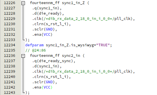

For a reliable synchronizer, don't use asynchronous reset like below code changes (screenshot):
Then the CDC-50001 warning disappear.

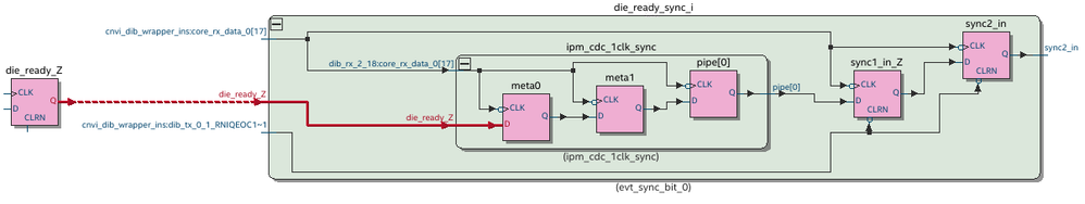

Just left this warning (screenshot below):
This is clearly not enough flip-flops for synchronizer (screenshot below):
