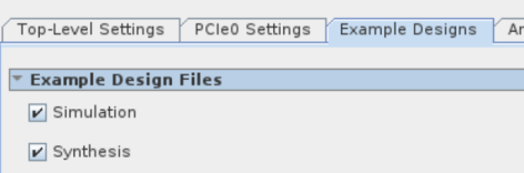

While Generating HDL, did you enable the option to generate simulation files as well ?
- RongY_altera
Contributor

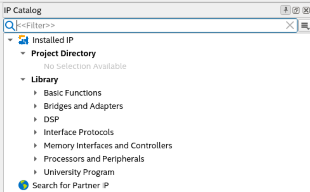

Use the IP Catalog to create an IP variant then generate an example design in that IP menu.
Make sure the Simulation is selected before you click "Generate Example Design"
Rong
