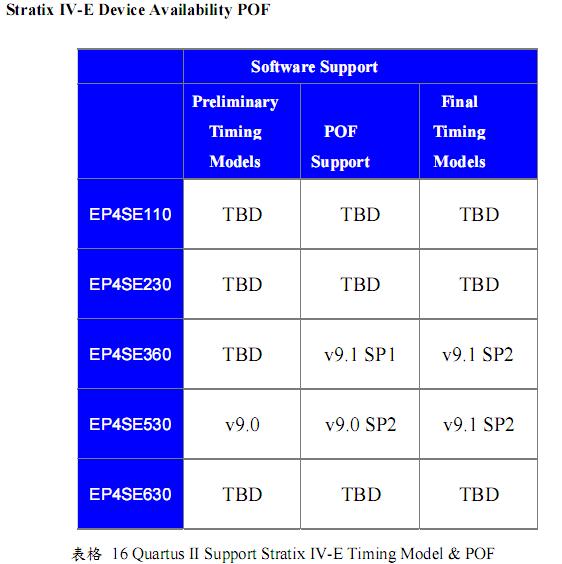

    Here is some info. I think if v9.0sp2 has pof support feature, then v9.1 does.
    http://www.alteraforum.com/forum/attachment.php?attachmentid=2024&stc=1&d=1264575490
