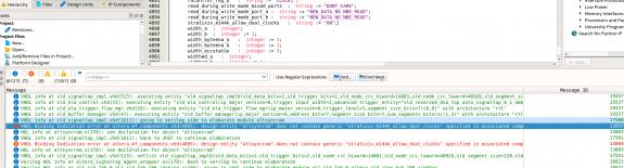

    https://alteraforum.com/forum/attachment.php?attachmentid=15788&stc=1
    Please see attachment of error.

    The screenshot is illegible.

    I am just trying to tap harmless signals such as clocks and resets. I think it is the memory used for SignalTap trace storage itself, that causes this altsyncsram error to occur.
    Re-attaching a clearer screenshot here: https://imgur.com/a/yxmt0ie
