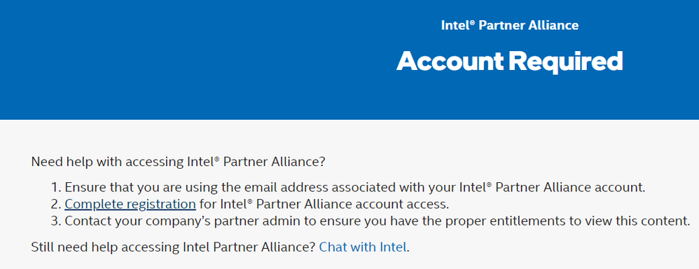

    • Boslong's avatar
      Boslong
      Thank you for the reply. Unfortunately, I'm still not able to access licensing, nothing seems to have changed. I was able to and can still see the "Self-Service Licensing Center" link in "My Tools", but when I click it, the following error message "Account Required" pops up. After clicking the link in step 2 "Complete registration", it loops back to the same page and that's where things are stuck. All I need is the free license for the starter FPGA software.
      Could you also kindly clarify your instruction "could you help to register again using the new email address"? What "new email address" should I use, can I register again using a personal email address for the free license?
      Thank you.

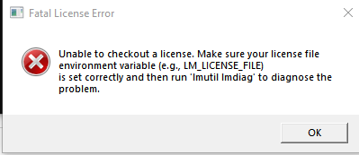

  • RFI's avatar
    RFI
    I was able to generate a license here, even thought there seems to be some new license center.
    https://licensing.intel.com/eval-free-licenses
    I was unable to get it to work however, even with setting the LM_LICENSE_FILE variable to the folder in which I put my license.
    running
    C:\Users\RF>lmutil lmdiag
    lmutil - Copyright (c) 1989-2019 Flexera. All Rights Reserved.
    FlexNet diagnostics on Mon 1/17/2022 12:06
    License file: C:\Users\RF\AppData\Roaming/XilinxLicense\Xilinx - Copy.lic
    "XC7Z020_EMBEDDED" v2022.03, vendor: xilinxd, expiry: permanent(no expiration date)
    vendor_string: [email protected],XC7Z020_EMBEDDED,software,permanent,_200503949_208823071_210739961_606
    uncounted nodelocked license, locked to ethernet address "b89a2a3a225d" no expiration date
    TS_OK: Checkout permitted when client is using terminal client
    This is the correct node for this node-locked license
    Any help?
    • RFI's avatar
      RFI
      I was able to resolve this by adding the license file name to the environment variable path, not just the directory.
      That is:
      <License file folder path> /license.dat
