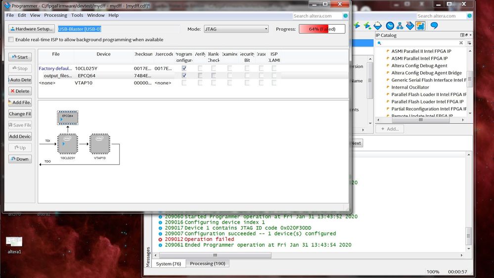

I was wondering if I can use Quartus Lite to in program the Serial device on my Cyclone 10 lp dev board?

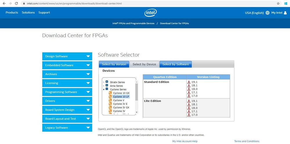

You can use either Quartus prime lite or standard editions of following versions of Intel Quartus tool,
https://www.intel.com/content/www/us/en/programmable/downloads/download-center.html

Yup, I have lite. The question is will 18.1, the windows version of Quartus lite erase the memory and program the serial memory by way of a jtag probe? AT present, I get a failure! See pictures.

Please refer the "4.4.2. Program On-Board EPCQ or EPCQ-A Flash Memory" from below user guide,
https://www.intel.com/content/dam/www/programmable/us/en/pdfs/literature/ug/ug-c10-lp-eval-kit.pdf
you can also see the below video for reference,
https://www.youtube.com/watch?v=dPSFCGNQOCU
please let me now, how it works for you.
