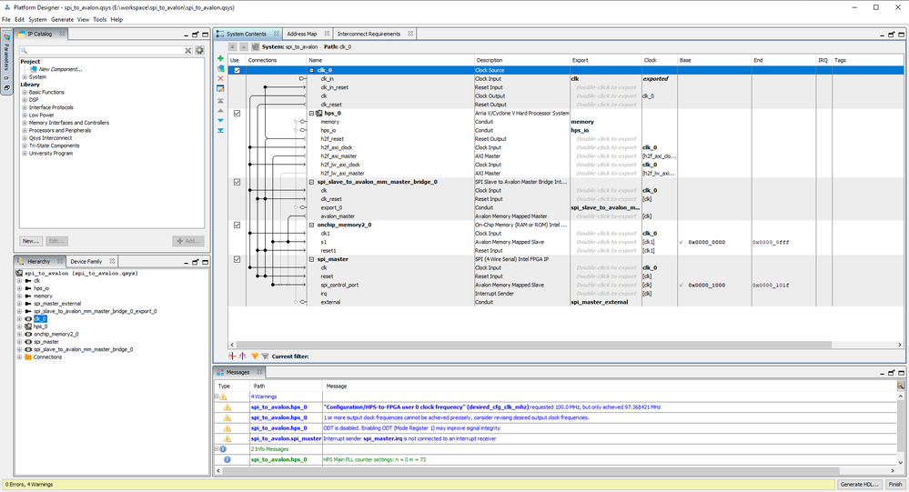

I created a project to implement spi communication so i implemented in two ways
using "spi (4 wire) intel fpga IP." and SPI slave to avalon master.
Please check the image below

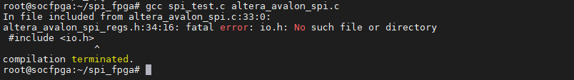

Compiled the project and created rbf file and header file. Please help me how to use the spi module available now on FPGA. I wrote the C program to control the SPI (4 wire ) which is also available in attached zip file. I used the header files available in E:\intelFPGA_lite\22.1std\ip\altera\sopc_builder_ip\altera_avalon_spi. but when i compile the the spi_test.c with altera_avalon_spi.c i get the below error message
Please let me know the solution or please point out anything if I am doing wrong.

Hi nsuggula
For using of the SPI device in the linux environment you do not need to compile the driver into your c code.
You could just add the device into the device tree and select the correct linux driver and it will appear in the linux /dev directory.
If you are happening to be developing in baremetal you could follow the guide here to setup the cross compiler.
https://www.rocketboards.org/foswiki/Documentation/HWLib
