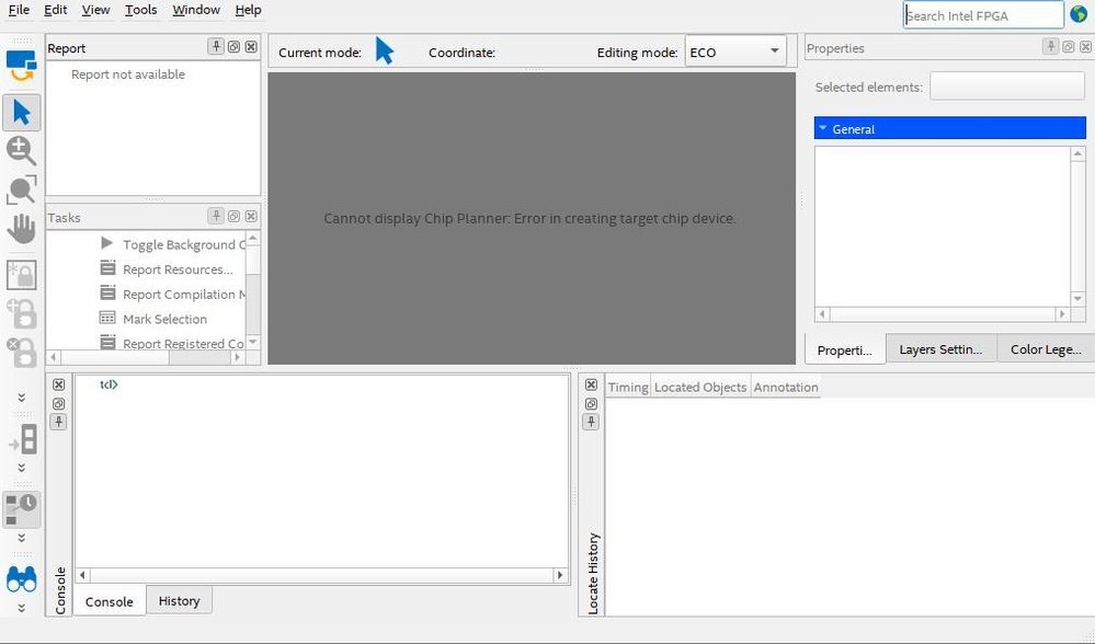

broken chip planner
Chip planner is broken in quartus 22.4 and 23.1 both Windows 10 and Linux versions
22.3 is OK both Windows 10 and Linux
Any solution?

    • PeterL's avatar
      PeterL
      Hi FvM,
      Thanks for tests. It turned out something has happened in device migration settings between 22.3pro and 22.4pro.
      I use Cyclone 10CX105YF780E5G and migration device 10CX150YF780E5G. Even when I start new design with migration set, chip planner fails. Without migration, it works fine.
      BUT there is a caveat, once you set migration and remove it later through menu, quartus still keeps in QSF file
      assignement
      set_global_assignment -name DEVICE_MIGRATION_LIST 10CX105YF780E5G
      which cause chip planner fail. It must be manually deleted from QSF.
      As I need device migration, I need to keep this assignment
      So, I consider this behaviour a bug in quartus
      Peter

  • Nurina's avatar
    Nurina
    Thank you.
    Can you also share the 22.2 design so I can reproduce the steps? I would like to check if this happens when migrating to other Quartus versions too.
    Nurina
  • Nurina's avatar
    Nurina
    Hi Peter,
    Please ignore my previous comment. I'm able to recreate the project in 22.2.
    Nurina
  • Nurina's avatar
    Nurina
    Hi Peter,
    Thank you for sharing this issue and design with us.
    I have reported this issue to engineering team.
    Since you have the workaround to this issue, may I know if I can close this case?
    Nurina
