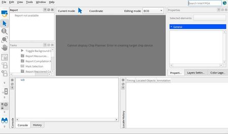

Chip planner is broken in quartus 22.4 and 23.1 both Windows 10 and Linux versions 22.3 is OK both Windows 10 and Linux Any solution?

Thanks for tests. It turned out something has happened in device migration settings between 22.3pro and 22.4pro.
I use Cyclone 10CX105YF780E5G and migration device 10CX150YF780E5G. Even when I start new design with migration set, chip planner fails. Without migration, it works fine.
BUT there is a caveat, once you set migration and remove it later through menu, quartus still keeps in QSF file
assignement
set_global_assignment -name DEVICE_MIGRATION_LIST 10CX105YF780E5G
which cause chip planner fail. It must be manually deleted from QSF.
As I need device migration, I need to keep this assignment
So, I consider this behaviour a bug in quartus
