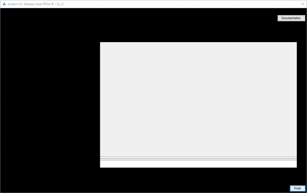

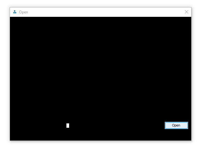

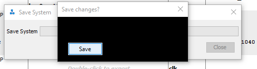

When starting the Platform Designer from within Quartus I have many black screens. When I move the mouse over this black screen, the items become visible. Or I have to move the screen outsite my desktop and move it back onto the desktop. Any idea what is cousing this, videocard issue?

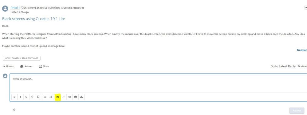

Maybe another issue, I cannot upload an image here.

When you mentioned many black screens, can you post a video/image on how this issue occur?

When you reply, there is an image icon (yellow highlight), left click and upload the image.

The main problem with black screens is using the Platform Designer.
