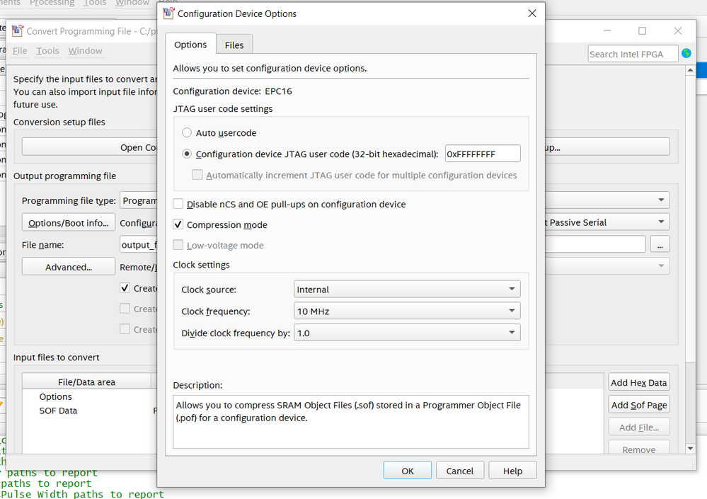

3.You can compressed the .pof by using convert programming file in quartus. Please refer picture attached.
Aiman

I can't use the Convert Programming file.
Error(20687): Convert Programming Files does not support the target device agib027r29a1e2vr0. Please use Programming File Generator to generate the programming file for the target device.How can I enable pof compression with quartus_pfg not quartus_cpf?
