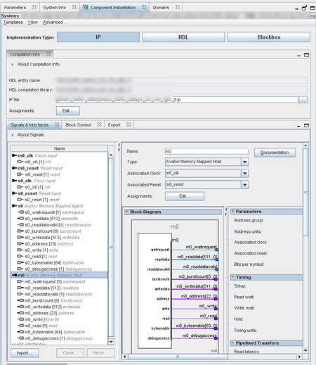

Hello, we would require a Avalon Clock Crossing Bridge with support for the Avalon Write Response & Write Response Valid signals. However the Avalon Clock Crossing Bridge does not show any options ...

Hi Fabian,
If so, I would suggest you to use Clock crossing adapter type handshake check this link https://www.intel.com/content/www/us/en/docs/programmable/683609/24-1/interconnect-parameters-59023.html to enforce that each write must fully complete before the next is accepted
Sheng
