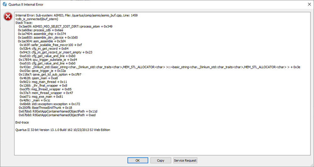

So, if during "Assembly" Task you're facing a cpp native code crash on asmio_buf.cpp file while using LVDS SerDes IO core (see picture), the solution is most probably as following:
For Quartus 13 and older:
Assignments -> Settings -> Fitter Settings -> More Settings -> Treat Bidirectional Pin as Output Pin = Off
For newer versions:
Assignments -> Settings -> Compiler Settings -> Advanced Settings (Fitter) -> Treat Bidirectional Pin as Output Pin = Off
