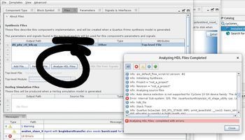

I encrypted the hdl file with encrypt_1735 (dti_phy_ctl_blk.v -> dti_phy_ctl_blk.vp)
"encrypt_1735 dti_phy_ctl_blk.v --language=verilog --quartus"
then I took that file to analyze and got an er...

Qsys invokes quartus_syn for the analysis of the HDL files. I don't think Quartus can decrypt unknown encrypted files, so this is expected behavior that it would fail on analysis of encrypted files

I encrypted the hdl file with encrypt_1735(Quartus encrypt tool). So I think it is not unknown encrypted files
- ShengN_altera3 years ago
@haianhle Based on internal feedback, unknown encrypted files also include Quartus encrypt tool (encrypt_1735). Feedback as below:
Is the file encrypted with the altera key?
If it is quartus synthesis can analyze it. Otherwise it can't.
