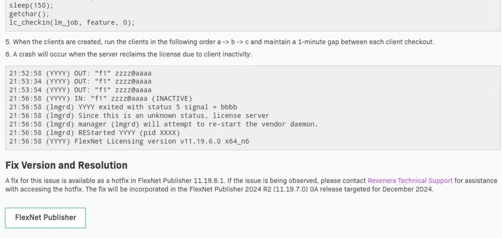

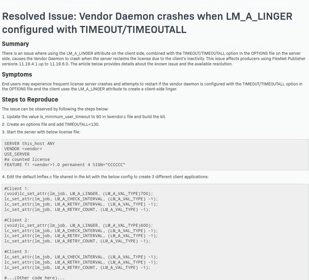

Please can you confirm that you have read my request and my other forum post linked above? All the information is there. Flexera have announced that there is a bug in their software introduced in 11.19.4.1 and fixed in 11.19.6.1. I don't feel like me doing any more debugging is a productive use of time. I just need a new version of alterad released built on the latest version of flexnet publisher. I'll screenshot their forum post so you can see for yourself.
