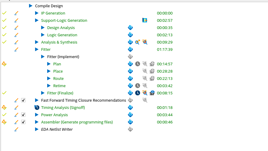

Algilex can not generate the programming file in Quartus22.3 pro

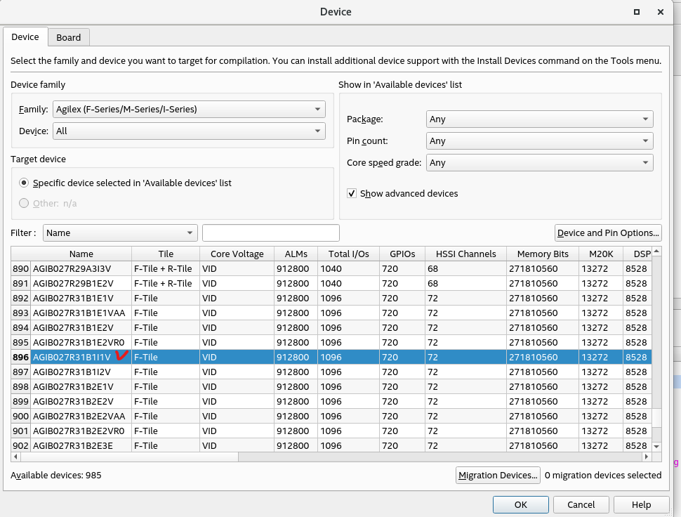

we try to create a new project on the AGIB027R31B1I1V

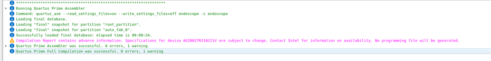

Critical Warning(18636): Compilation Report contains advance information. Specifications for device AGIB027R31B1I1V are subject to change. Contact Intel for information on availability. No programming file will be generated.
- sstrell
The message explains it all. You've selected an advance device and Quartus 22.3 can't create a programming file. Have you tried 22.4? Maybe support was just recently added.

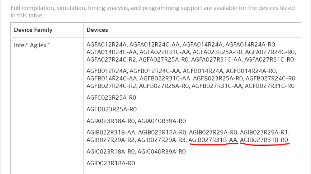

from the 22.3 release note info this device will be supported
Algilex -F & I be supported from Quartus22.3
we could select the device type from 22.3

You are getting this warning because the timing models for this device are not yet final. Hence SOF generation also is not enabled yet. If you use the new version quartus it may solve this issue. In the other hands, there is an ini can help you skip this issue to continue your debug process I will email to you.
