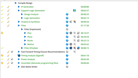

3 years agoAlgilex can not generate the programming file in Quartus22.3 pro
we try to create a new project on the AGIB027R31B1I1V
Critical Warning(18636): Compilation Report contains advance information. Specifications for device AGIB027R31B1I1V are subject to change. C...

3 years agoThe message explains it all. You've selected an advance device and Quartus 22.3 can't create a programming file. Have you tried 22.4? Maybe support was just recently added.
