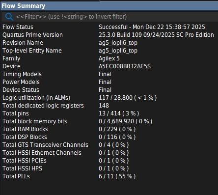

- ShengN_altera9 months ago
Could you try using latest Quartus v25.3? Screenshot:
- MAC_Yossi8 months ago
I was able to confirm it in v25.3 as shown attached.
As a conclusion, since v25.3 is also compiled, is it correct to understand that there is no problem with v 25.1?
At this moment, it is necessary to develop with v25.1 to match the version of IP made by 3rd Party.- ShengN_altera8 months ago
