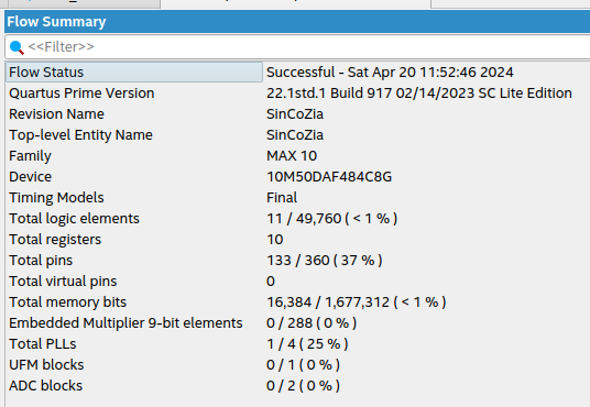

Now when compiling that code, the memory usage is 16k (16384 bits to be accurate).
Could anybody explain me what's wrong and how to fix it?

  • Can't be answered without seeing the complete design. Most likely two bits are redundant (not driving actual logic).
  • FvM's avatar
    FvM

      Thanks for your reply. Indeed, what you describe is right. I wanted to build a complete new version
      from scratch because of beginner problems in my very first project, beginner that I still am.
      I oversimplified the project. It used to make a linear interpolation between 2 consecutive samples,
      caculating in 18 bits, then rendering the result in 16. An for a start, I was using only one of the
      samples (i.e. no interpolation), therefore the 2 last bits were not used at all.
      Thanks a lot for your help, it works now, and the compilation reports 18432 bits used, which is
      exactly 18 * 1024. The numbers match, now.
